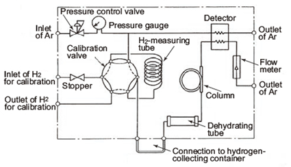

The [H]D content of weld metal has been measured by several methods: glycerol displacement as per JIS Z 3118, mercury displacement as per ISO 3690 and AWS A4.3, and gas chromatography as per JIS Z 3118, ISO 3690, and AWS A4.3. However, the glycerol displacement method has the problem of low accuracy in measuring a low amount of [H]D (2 ml/100g or less), and the mercury displacement method has the problem of environmental pollution. By contrast, the gas chromatography has no such problems. This is why, today, the gas chromatography is commonly used for measuring the [H]D content of the weld metals produced by the SMAW, GMAW, FCAW and SAW processes.
With the gas chromatography method specified by the JIS standard, a small steel piece, e.g. 10T×15W×30L for SMAW, is welded with a single bead using the covered electrode to be tested. Soon after the welding, the weld specimen is cooled in ice water and is cleaned with a wire brush. Then, the weld specimen is put in the hydrogen-collecting container, followed by the argon purging to remove the air in the container. The hydrogen-collecting container is kept for 72 hours in the constant-temperature (45°C) container to collect [H]D. To measure the amount of [H]D, the hydrogen-collecting container is connected to the measuring apparatus as shown in Figure 1.
Figure 1: Instrumental components of the gas chromatography method for determining the [H]D content of weld specimens.
