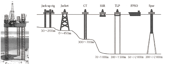

Off-shore Structures
Various offshore structures are constructed at underwater oilfields to match the environment and the depth of the development. A strength and toughness suited to the ocean environment is necessary, and a high strength and excellent low temperature toughness are required in the structural steel and welding materials used.
Types of offshore structures and their working water depth

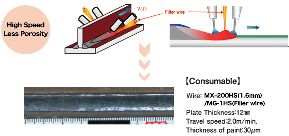

Assembly Longi./Fillet Horizontal GMAW MX-200
MX-200H
MX-200HS
MX-200E
MX-200H
MX-200HS
MX-200H:Twin tandem one pool
MX-200HS:TRIFARC™

TRIFARC™ Method(High Speed Triple Tandem One Pool Method)& RF™ Process
High Speed Triple Method
RF Process
RF Process
MX-200H
MX-200HS
MX-200E
MX-200H
MX-200HS
MX-200HS:TRIFARC™
