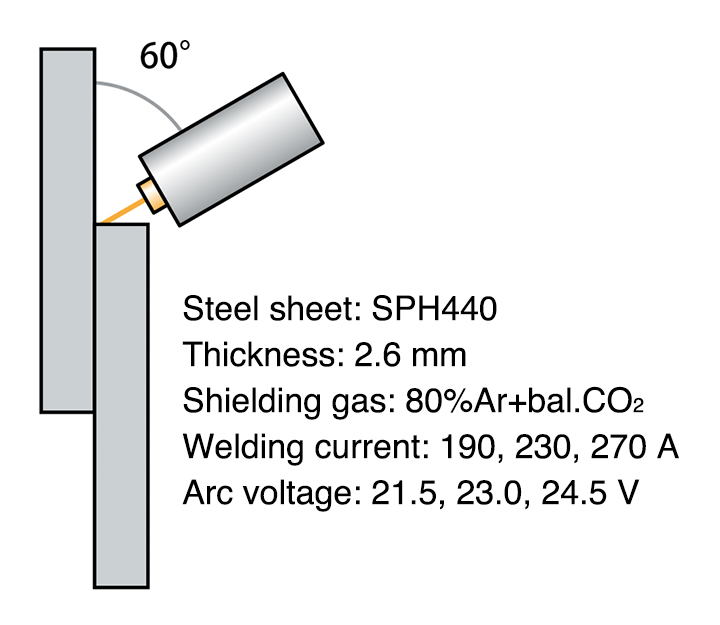

Penetration and bead configuration are important for welding undercarriage components, which are required to carry loads continuously. In actual welding of undercarriage components, weld gaps frequently occur because of the unevenness of component-shapes as a result of how they were pressed during fabrication. It is, therefore, necessary to produce sound bead shapes even though a certain degree of gap may exist. Additionally, preventing undercut during welding is essential because it contributes to a decrease in fatigue strength.
Figures 4 and 5 show the results of an evaluation of gap tolerance in lap joint welding in flat position between [F] MIX-1TR and a conventional solid wire and the welding conditions, respectively.
Gap [F] MIX-1TR Conv.wire
(Conventional wire)
0 mm
1 mm
Figure 4: Comparison of gap tolerance between [F] MIX-1TR and a conventional solid wire in lap joint welding in flat position
Figure 5: Welding conditions of lap joint welding in flat position
in flat position
Sufficient penetration was obtained from both solid wires. However, in the welding of a test specimen with a 1 mm gap, [F] MIX-1TR did not cause undercut, while the conventional solid wire clearly generated undercut at the toe of the lower side steel sheet.
Automobile components are frequently welded at relatively fast speeds, which can cause beads to become more convex in shape as a result of the lower heat input. However, because a convex bead shape leads directly to reducing fatigue strength, producing such shapes must be avoided.
Figure 6 compares the bead configuration produced by [F] MIX-1TR and a conventional solid wire in lap joint welding in horizontal position. Figure 7 shows the welding conditions used in the experiment.
Wire Travel speed (mm/min)
800 1000 1200
[F] MIX-1TR
Conv.wire
(Conventional wire)
Figure 6: Comparison of bead configuration between [F] MIX-1TR and a conventional solid wire in lap joint welding in horizontal position
Figure 7: Welding conditions of lap joint welding in horizontal position
When the conventional solid wire was used, the bead shapes gradually became convex as the welding speed increased; however, beads produced by [F] MIX-1TR varied little and remained stable despite increasing welding speed.
