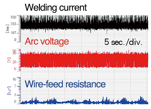

The test welding was conducted by using the wire feeding path shown in Figure 5, and the comparison result of time variation in the behavior on the tested welding current, arc voltage and wire feeding resistance between a conventional wire and [F]MG-1T(F) is shown in Figure 6. It was found that fluctuations in wire feeding resistance were limited.
Figure 5: Schematic drawing of wire feeding test
Conventional wire [F]MG-1T(F)
Figure 6: Time variation of welding current, arc voltage and wire feed resistance between a conventional wire and [F]MG-1T(F)

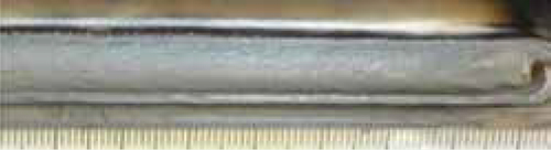

Furthermore, the combination of 95%Ar-5%CO2 shielding gas containing a high Ar ratio with a conventional pulsed power source reduces slag generation while increasing porosity resistance on galvanized steel sheets. Figure 9 compares bead appearance produced by a conventional solid wire (equivalent to JIS Z 3312 YGW12) and the Metal Act ive Gas (MAG) welding proces swith 80%Ar-20%CO2 shielding gas (conventional process) and 95%Ar-5%CO2 shielding gas (Hi-Ar Process).
In contrast to the conventional process, which produced dotted slag on the bead, the Hi-Ar Process resulted in aggregated slag at the weld-end, a so called crater, which can minimize the places where electro-deposition coating defects can occur.
