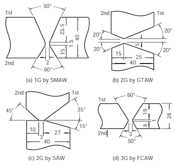

A butt joint welded on 9% Ni steel by DW-N709SP yielded satisfactory results in tensile, impact, CTOD, and bend tests as shown in Table 7. The macrograph of the weld joint and the appearance of the bend test specimens are shown in Figure 4. And Figure 5 shows the FISCO crack test result of DW-N709SP weld metal. The crackfree zone has become much wider, even at faster welding speeds, when the susceptibility against hot crack becomes quite critical.
Figure 5: FISCO crack test results of PREMIARCTM DWN709SP weld metal, showing superior hot crack resistance over conventional FCW.
DWN709SP
Table 7: Welded joint properties of PREMIARCTM DW-N709SP in 3G welding position
Properties Measurements
Tensile strength at room temp.*1 738 MPa
(Fractured at weld metal)
Impact toughness at −196°C 88, 91, 89 (Av. 88) (J)
CTOD at −196°C (δM) 0.39, 0.39, 0.38 (Av. 0.38)
Longitudinal bending, 180° Good
*1: Base metal is ASTM A553 Type I, 28mm thick, double-V groove.
Figure 4: PREMIARCTM DW-N709SP exhibits complete fusion in 3G-position butt joint and excellent ductility in bend test.
test.

Figure 7 shows examples of groove configurations for SMAW, GTAW, SAW and FCAW in designated welding positions in the figure. Figure 8 shows horizontal fillet welding (2F) on the roof of an LNG tank with DW-N709SP flux cored wire. Figure 9 shows overhead butt joint welding (4G) along the bottom plate of an LNG tank with automatic TIG welding equipment using TG-S709S TIG wire. These pictures were taken at a construction site in Japan where the major aboveground LNG tanks use the flat-bottom double-shell cylindrical dome-roof structure (Figure 10). The dome roof is also made of 9% Ni steel.
Figure 7: Typical groove configurations for SMAW, GTAW, SAW, and FCAW used for joining 9% Ni steel components in fabrication of an LNG tank.
