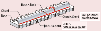

On the other hand, the lower part (below sea level) of a jack-up-rig, which must bear the load of ocean waves and tidal flows, requires the application of YP690MPa class steels in order to lessen a rig’s total weight and improve the load bearing capacity as well. In addition, reliable welding consumables and procedures are required in order to secure appropriate notch toughness and cold crack resistance.
All-position welding consumables are essential for jackets in particular because they have multiple large diameter pipes for TKY joints as seen in Figure 5.

3-1-1. TRUSTARC™ LB-80L
Figure 6: Example of welding processes for a rack portion of a jack-up-rig
For welding YP690MPa class steels requiring high notch toughness as well as cold crack resistance at low temperatures, ultra-low hydrogen covered electrodes (low in oxygen as well) still play a major roll. LB-80L (AWS A5.5 E11018-G H4), which was designed for DC welding, satisfies all of these requirements as shown below. Figure 6 shows an example of welding processes for rack portions of jack-up-rigs, where YP690MPa class steels are mainly used.
