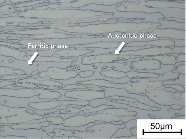

Duplex stainless steel, which has a dual-phase microstructure consisting of ferritic and austenitic grains, as shown in Photo 1, overcomes the weaknesses associated with two types of steel by offering higher resistance to stress corrosion cracking than austenitic stainless steel and better notch toughness than ferritic stainless steel. Duplex stainless steel plays an important role in such diverse applications as petro-chemical plants, chemical carriers, offshore structures and bridges as shown in Photos 2 and 3. This article will discuss the features of duplex stainless steels as well as their most suitable welding consumables.
Photo 1: Microstructure of duplex stainless steel

The microstructure of duplex stainless steel shows that the austenitic grains have precipitated on a completely ferritic phase with a phase balance of approximately 50% ferrite and 50% austenite. As this condition is the most stable of microstructures, the features of duplex stainless steel can be highlighted.
