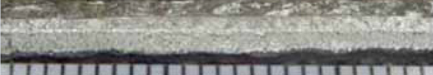

Figure 3 shows the bead appearance and cross-sectional macrostructure in both horizontal fillet welding and lap fillet welding of [F] SE-1Z .
Horizontal fillet weld: 180A-22V-500mm/min; Sheet thickness: 2.3mm; Zn coating mass: 90g/m2
Lap fillet weld: 175A-21V-500mm/min; Sheet thickness: 2.3mm; Zn coating mass: 90g/m2
Bead appearance
Macrostructure
Figure 3: Bead appearance and cross-sectional macrostructure of [F] SE-1Z (1.2mm dia.) weld
Lap fillet weld: 240A-30V-450mm/min; Sheet thickness: 3.2mm; Zn coating mass: 135g/m2
Bead appearance
Macrostructure
Figure 4: Bead appearance and cross-sectional macrostructure of [F] MX-1Z (1.2mm dia.) weld

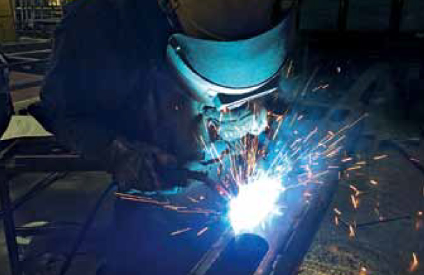

The photos in Figures 9 and 10 show the welding of a frame structure for a bus with [F] SE-1Z and of a water pipe with [F] Z-1Z.
![Figure 9: Welding a frame structure for a bus with [F] SE-1Z](../../images/education-center/technical_hightlight/vol26_31.jpg)
![Figure 10: Welding a water pipe with [F] Z-1Z](../../images/education-center/technical_hightlight/vol26_32.jpg)
